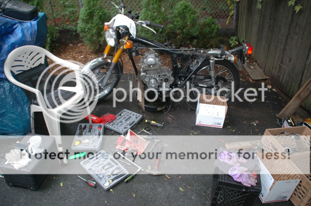

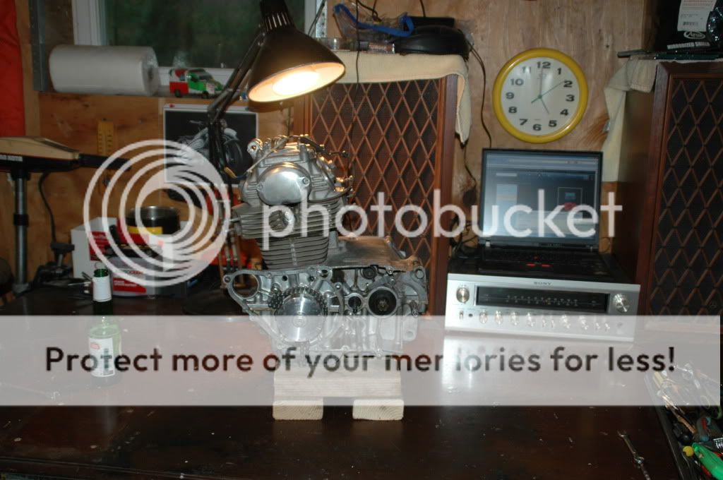

Yesterday I decided that I have to take the engine out. There was no other way around  it.
Here I am getting ready:
Few hours later the engine was free and ready to be taken out:
Then the big guns came to the rescue:
 And voila:

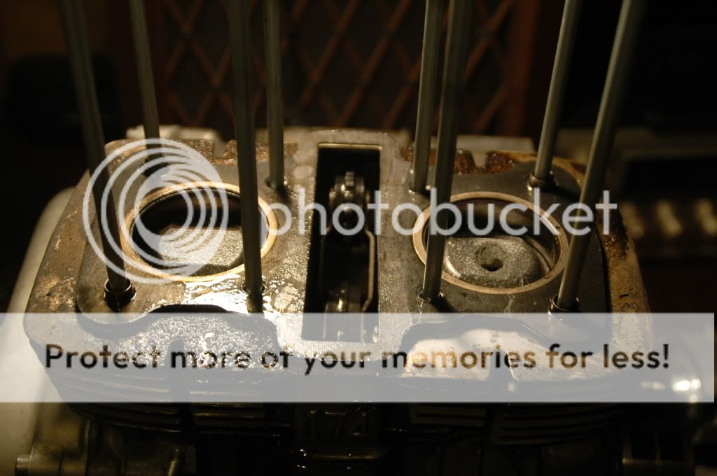

This morning I found the reason for the 0 PSI in the cylinder:
To be continued...

Peter,
That hole in the piston looks suspiciously similar in shape and size to the valve above it. What's the inside of the head look like?
Also what do the spark plugs show you concerning fuel mixture, there does not appear to be any carbon on the tops of the pistons.

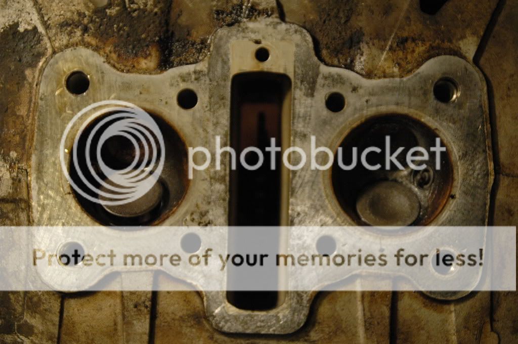

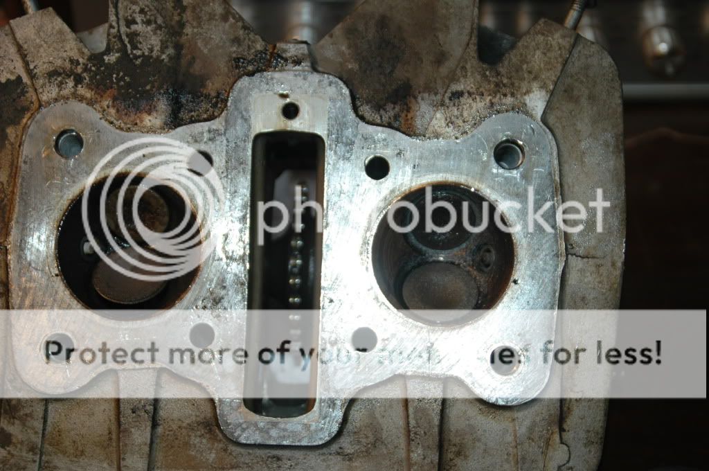

Here is how the head looks. The spark plugs look good in my opinion, but what do I know? They are new and the fuel mixture was okay (I think) because the bike ran very well.

« Reply #23 on: September 26, 2011, 01:50:19 AM »
Looks like the exhause valve on the left side might be to blame for holing the piston as it looks like it is not seating. What's keeping the valve open Peter, or is it just my old eyes that make it seem that way?
One of the valves is open, yes. Perhaps that is the reason. I haven't had the time to take it apart, or even examine it closely. The weather was so nice yesterday, so I took advantage of it and went for a little ride with the sidecar and Silva in the morning and with Eric in the afternoon.
