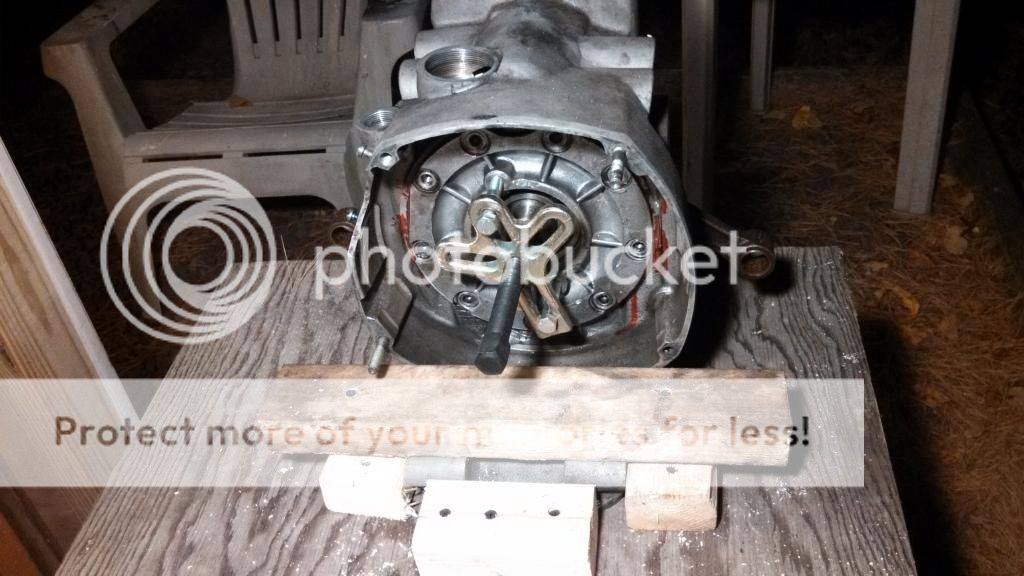

Thanks, John! I am far from needing tools for assembly. I am still trying to figure out how to disassemble the crankshaft. At the moment I am trying to remove the rear bearing housing, which is a big pain in the neck!
Here is how the housing looks like when removed:
A bit frustrated at the moment,
Peter

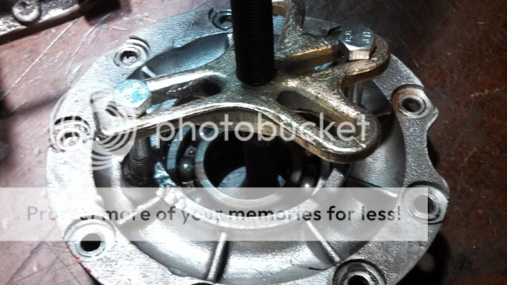

Nope, I haven't Angry!
I borrowed the picture form someone else, just to illustrate what I need to achieve. I will be home all evenings with the exception of Thursday. If you are free stop by, but call just to make sure I am there.

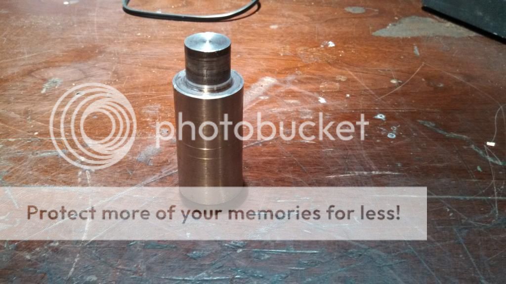

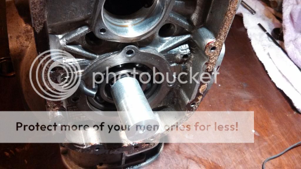

Okay, so here is what’s going on actually. I have tried to remove the rear crankshaft cover (or bearing housing) couple of times, but I was unsuccessful. I even managed to strip the threads where the pulley attaches to the cover and I had to tap new ones. Anyway, couple of weeks ago John came over to see if we he can come up with a solution as to how to remove that crank cover/bearing housing. After few beers we had a plan for action. He went home and made an aluminum piece which fits at the end of the crankshaft.
The idea was to bang on it to avoid damage to the crankshaft as I was still hopping that something else was a miss. I have attached the block to the table, so it wouldn't move.

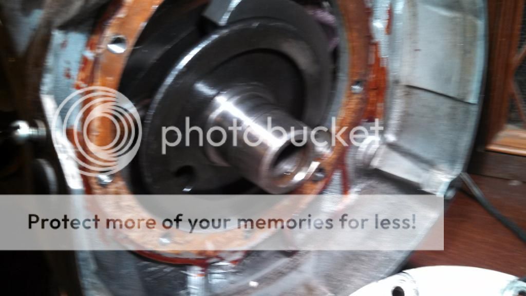

John came back last Friday and with the help of the pulley, some heat and a bit of banging - the cover finally came off - the plan worked!
After a few minutes of wondering and with the help of the internet, we were able to remove the crankshaft.
Unfortunately we discovered that the crankshaft is indeed bent and it would have to be replaced. That’s the situation at the moment.
